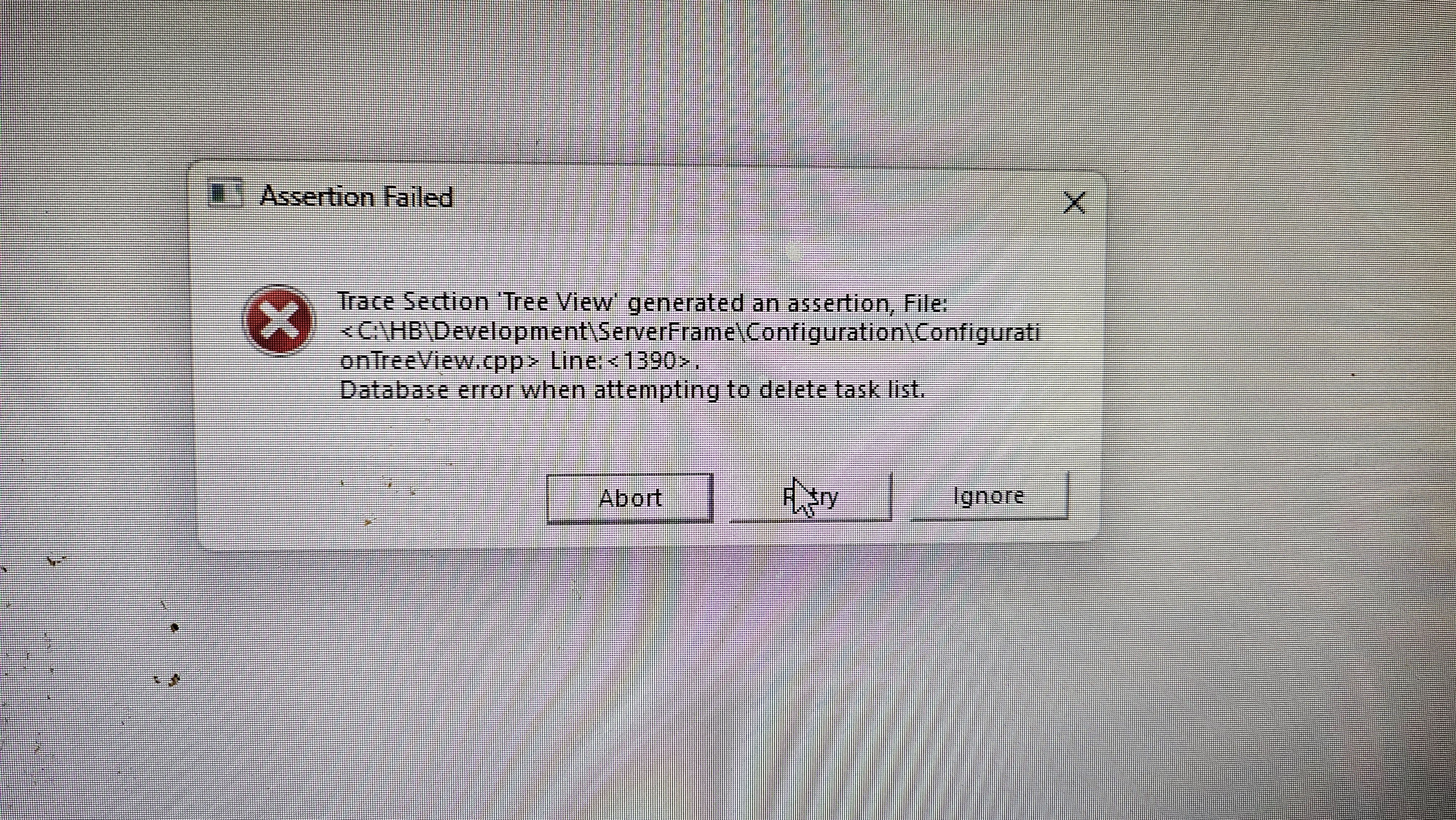

I have run in to a minor issue. When i try to delete an unused hardware interface or task i get an error message. See attached lousy screen grab. (Same file reference each time but different line #, IIRC. I haven't attempted any other clean-up but would like to weed out some of the old stuff at some point.

Looks like your database might still be a little corrupt. You will probably need to delete the data in the DB directly (or send it to me and I can look into it). If you have any questions about the tables and relationships, let me know.

The Deleting Things problem... went away. I had just shut down HB and rebooted, for another non HB reason. After rebooting and restarting HB, I created a test device to see if I could delete it. And I could. So I tried again to delete a task that I previously gotten that error message on. Deleted successfully. Same for an unused hardware interface, deleted just fine. Go figure.
