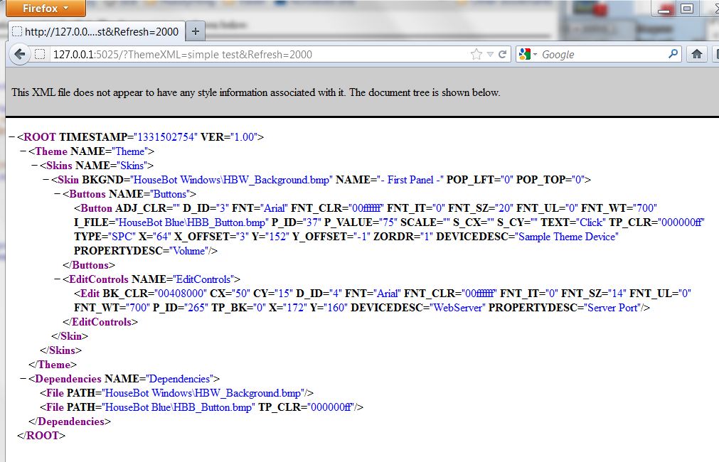

One error gone and new ones comming up. I did remove the Main1" button." entry and now I got this error:
Same problem as Steve, duplicate attributes but this time it is TP_BK

I made a very simple Theme, just a button and a text edit box. Now its missing style in formation! The theme works fine with Software Remote.

Maze42, you should be using ?Theme=simple test&Refresh=2000. ?ThemeXML just displays the XML and/or errors with the XML. The ?Theme is what loads the webremote client and calls the XML behind the scenes.
