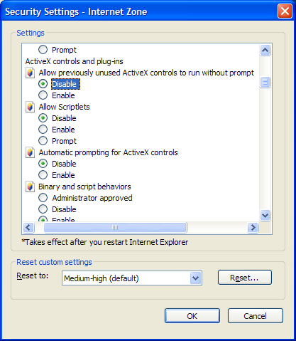

Further to my last post, please see screen shot of Internet Explorer security settings below.
Have a mess around with the settings...
Allow previously unused ActiveX controls to run without prompt
and
Automatic prompting for ActiveX controls
I'm probably completely off course :oops: But worth a try!
Let me know how you get one.

Thanks for the tip but that didn't seem to work, any more ideas?
Cheers,
Martin

allanstevens wrote:Further to my last post, please see screen shot of Internet Explorer security settings below.
and
Have you got anywhere with duplicating the dialog box yet? I have been playing with security settings etc. but no joy. The answer may lie in adding it to some trusted site list but I dont know what "site" to add.
Let me know if you get any further.
