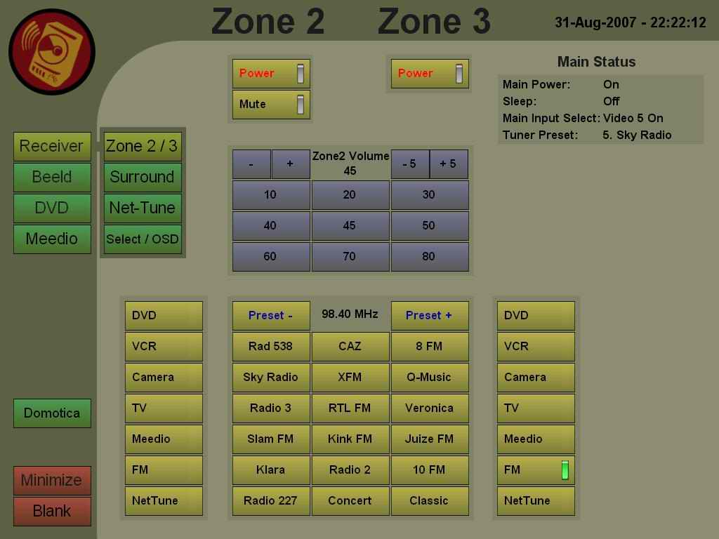

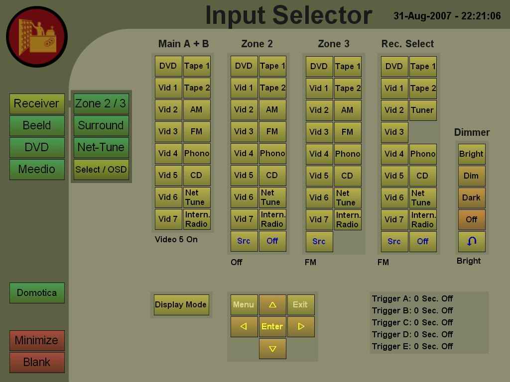

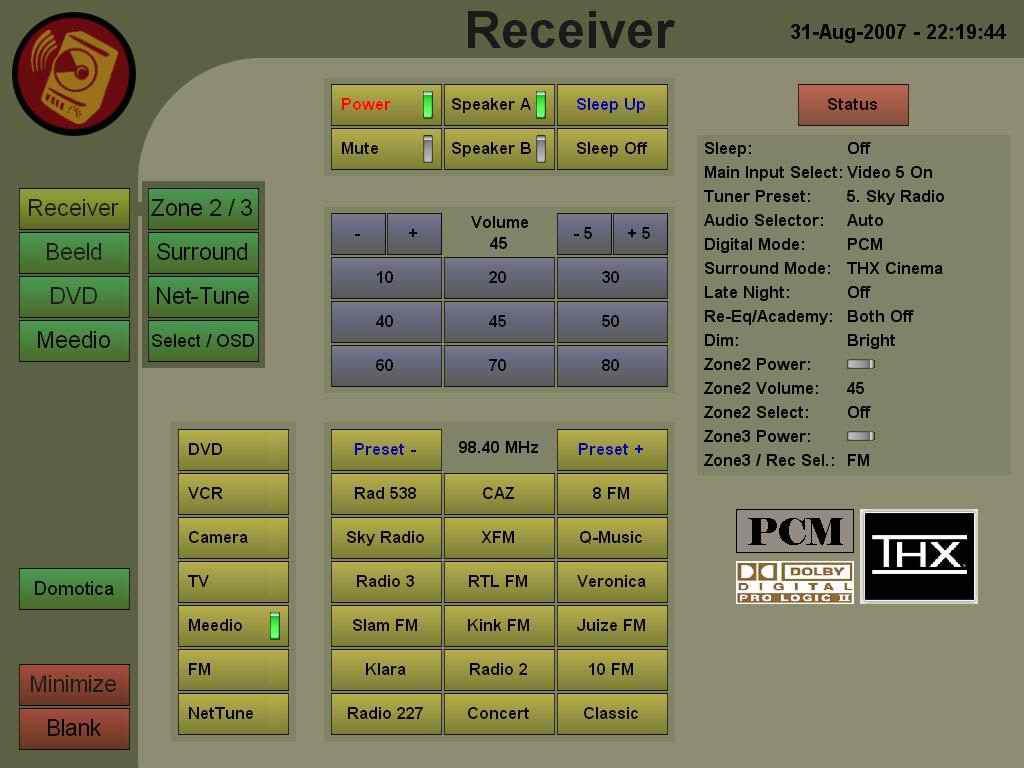

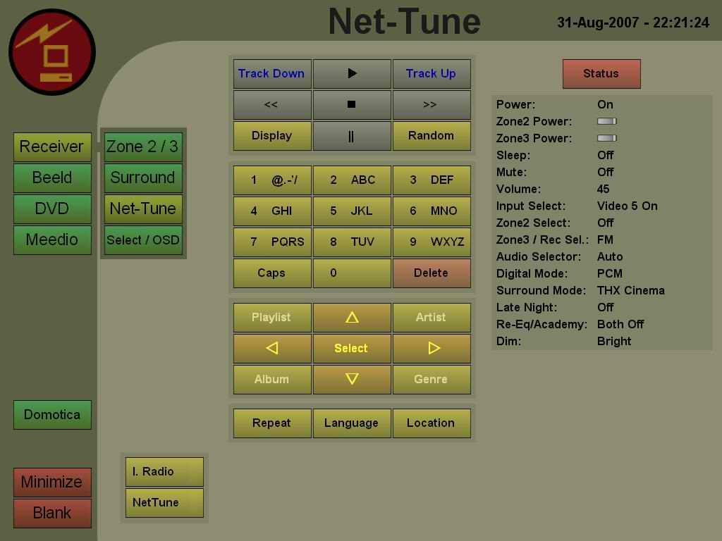

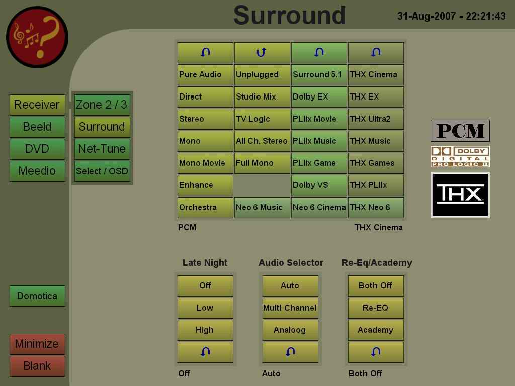

Receiver pics cont'd
All source buttons have indicators that don't show when not selected, show green when selected and On and show grey when selected while the receiver (or zone) is off.
The surround and digital mode labels follow the receiver correctly. Whatever surround and digital mode (inclusive THX overlay) the receiver is in, the theme panels (Receiver and Surround) display the correct icons.
After I built these icons I got the black background issue on these panels.
All of this is rs232 bi-directional (with status) using a continuous running script. Using the remote or the receiver itself will also update the theme panels.
Don't mind my terrible graphics. Maybe sometime Incoronade will beef it up :wink:

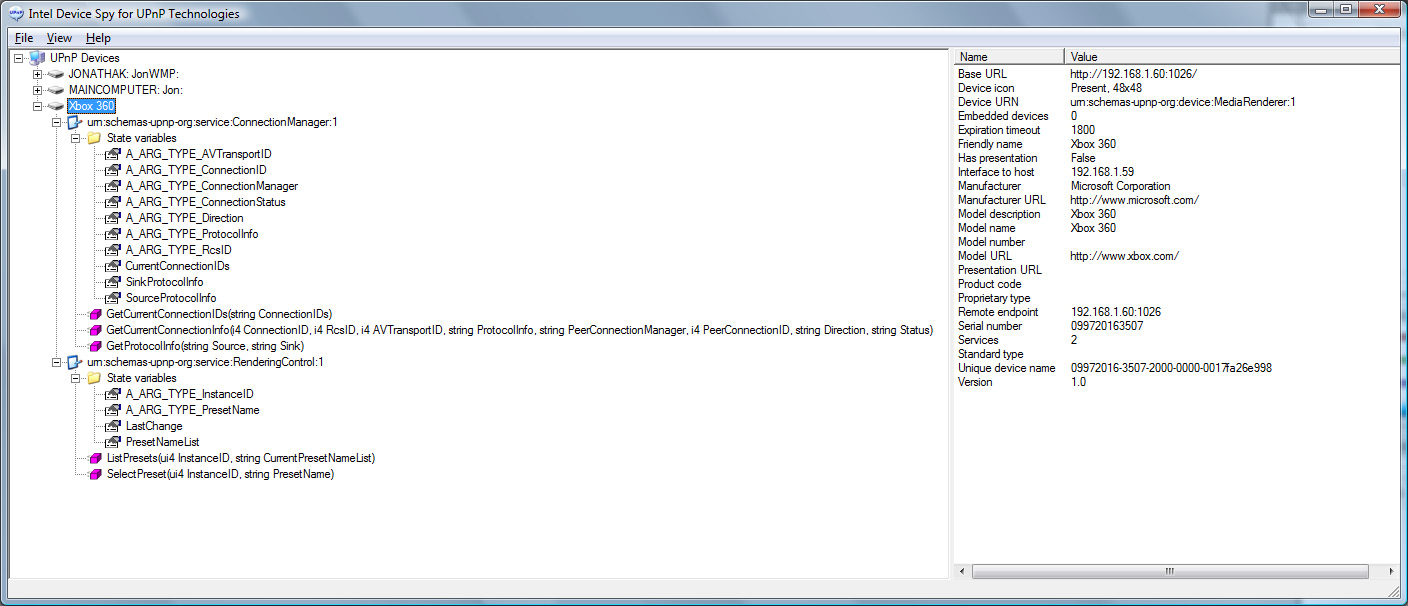

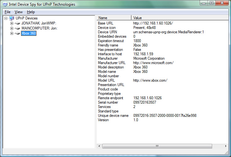

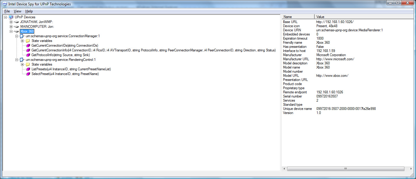

Excellent....this will be very easy to do via UPnP. Do me a favor and simply click on the xbox name in the left pane without expanding the tree and take a screen shot for me. Also take one with both items expanded. I also need to see the device type which should show up in the right pane with just the device highlighted.

Here are the screenshots....
