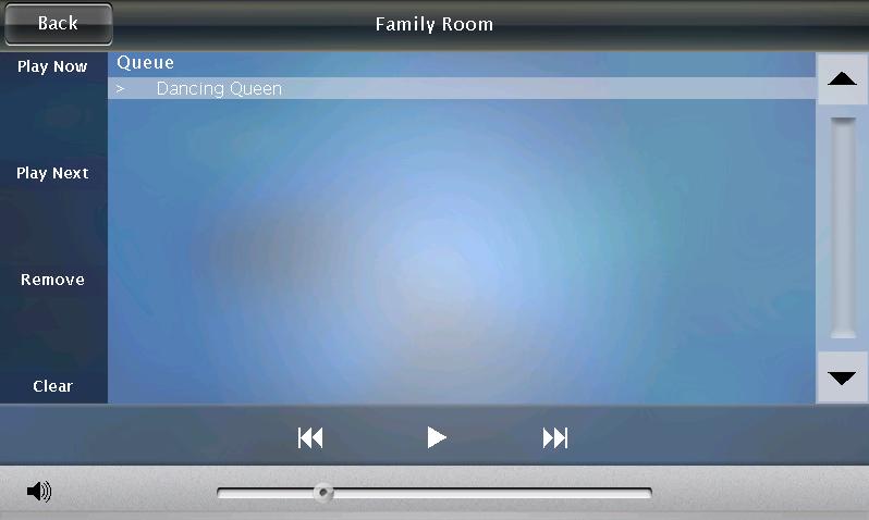

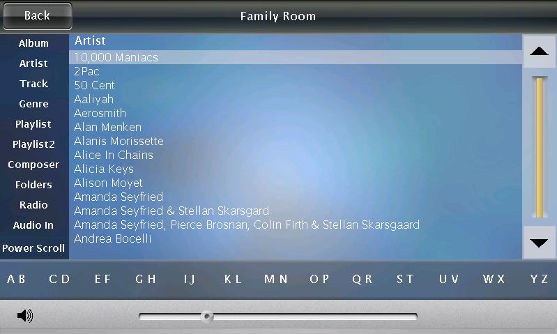

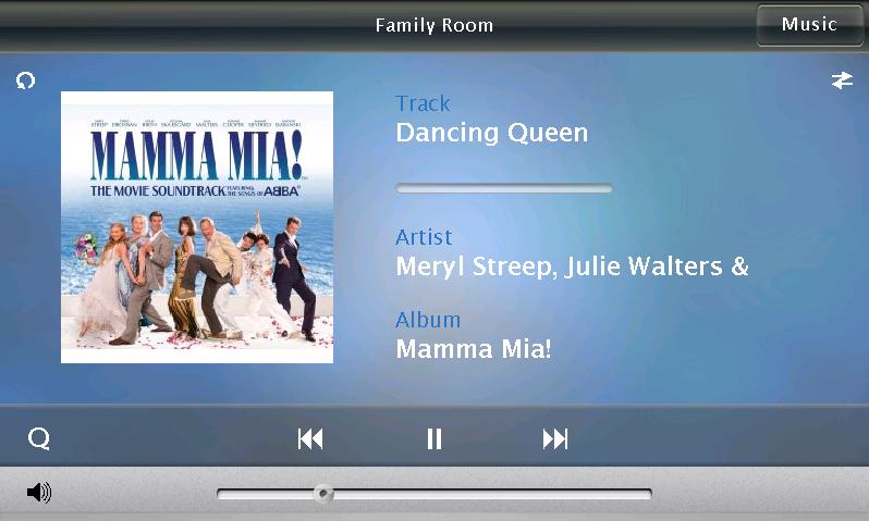

Re: Calling Sonos users
Some screenshots of the new theme. The Music Menu shot demonstrates the quick navigation buttons on the left of the screen and also has the power scroll feature activated for the selected sub-menu.
- isonos_nowplaying.JPG (44.94 KiB) Viewed 16418 times
- isonos_musicmenu.JPG (46.82 KiB) Viewed 16418 times
- isonos_queue.JPG (28.71 KiB) Viewed 16418 times
