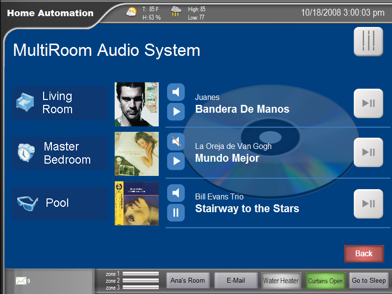

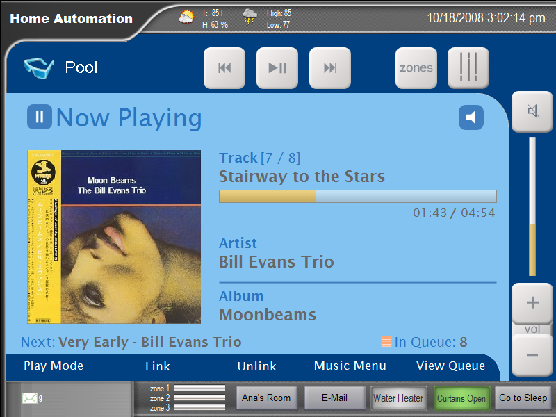

I wanted to thank you for the great script. It has been working just perfect and I was able to integrate the panels shared by you to my Theme without a lot of effort. I am including two screenshots of how they look.
Thanks again,
Victor
Thanks again,
Victor
- Now Playing Panel
- Sonos2.png (233.03 KiB) Viewed 17804 times
- Zones Menu Panel
- Sonos1.png (243.71 KiB) Viewed 17801 times

Those look great, Victor! I am glad it is working for you. Let me know if you have any feature requests or little inconsistencies that irk you.
