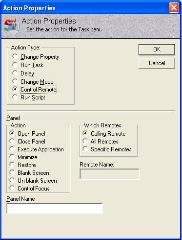

While right clicking on a theme panel of a running SWRemote, you will find an option "Always on Top".John_Paul_128 wrote:Using transparencies, how do you keep SWremote as the front/top app?
Can you please elaborate on the suggestion of using the "panel enter and exit to execute the task to start and stop the program of interest"
Just like you can Minimize a remote from script using MinimizeRemote(), you can Restore a remote the same way using RestoreRemote().
From a task this can be done as well. Look below for the window that has these options.
As for the Enter and Exit lists, you can find these options as Tabs from a themepanel property window while in the theme editer. Just right click on a theme panel in the editer and choose Properties and look for the Enter and Exit tabs. You can put commands in these lists that will execute respectively while opening aor closing a theme panel.
Please do a search for the keywords in the very good helpfiles as well since you will probably find most of your answers there and explore even other good stuff to get you going. The help files are stored in the HouseBot/Help/ directory
- naamloos.JPG (33.86 KiB) Viewed 6155 times
