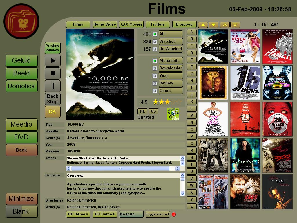

OK, my logic is completely different. I would want to browse my movie on my touchscreen leaving the TV or projector for what it's made for: displaying a running trailer or movie. This way you can select music, movies, trailers, tv recordings or what have you while the tv is displaying a trailer or something else. I like to watch trailers and while watching one, I am selecting the next one using my swremote on the touchscreen which sits next to my chair. Attached one of my movie panels using housebots swremote. It interfaces Meedio.

I wrote a complete interface layer between HouseBot and Meedio using the Meedio message stream and the power of Meedio's databases and its importers. This way all my my media is tagged properly.
