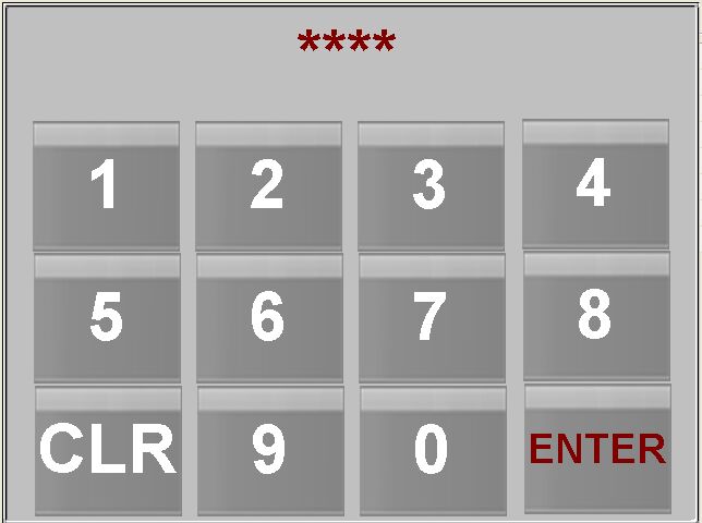

Attach is a script I have for a numeric keypad with the help of scripts I found on the forum...Very Elementary, still learning this scripting stuff. Keep the script coming!!! No matter how small. It helps me to learn coding and vb script.
Here is the actual script and also attached is a HB export to be imported if you chose too.
