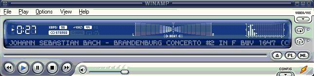

Is there a property in the Winamp device that captures the "currently playing" marquee stream that some internet radio stations supply? See attached.

The current plugin doesn't support it. I'll look to see if there's anything in the API that would allow it. If there is, I may be able to add it to the plugin for the next release.
